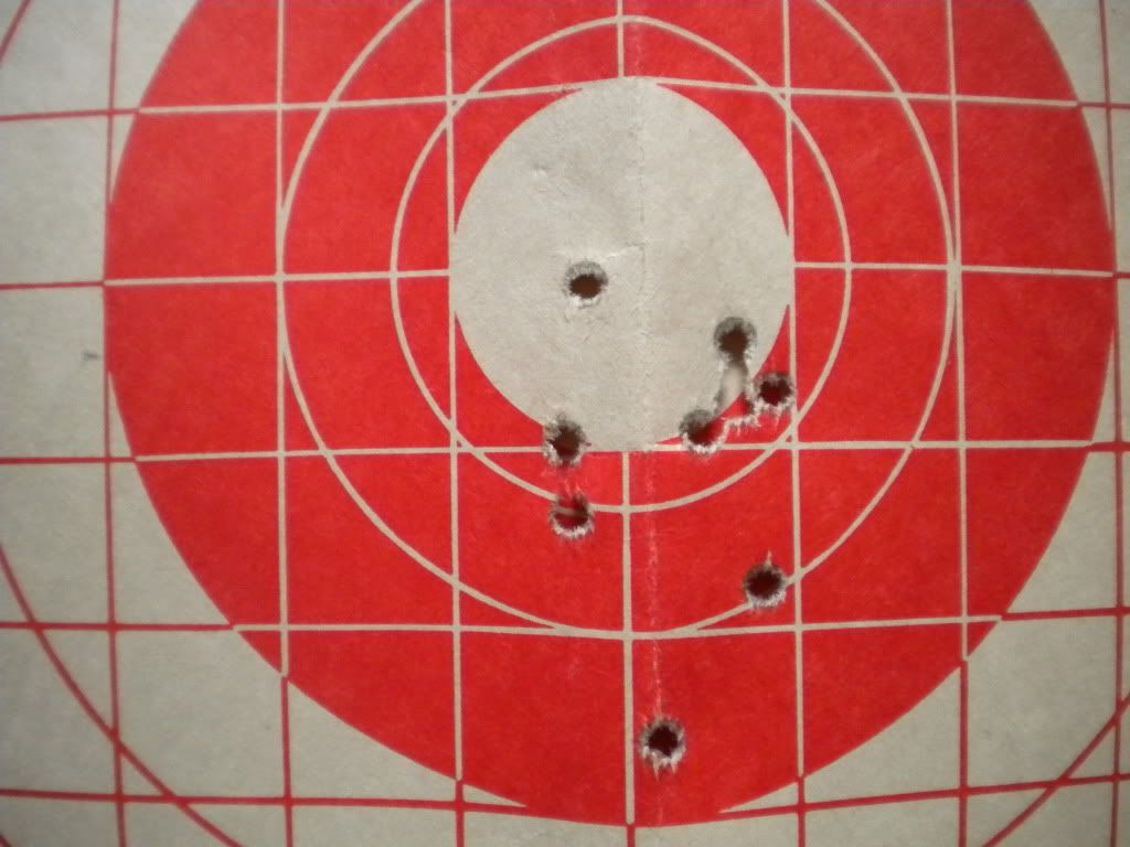

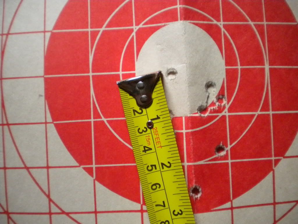

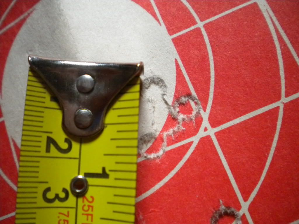

I finally got down to Wichita to sight in my rifle at Bullseye. They have a 100 yard indoor range and I figured that it would work out better than my last range session outside. I have shot my rifle 3-4 times now and I don't know what the deal is but I'm having issues. First time out I had a cheap scope that wasn't working for crap. Second trip out I had my SWFA SS scope and things went a little better. Shot well under 1 MOA with stock everything. Then I upgraded the stock to an HS precision with full bedding block. Went out and couldn't even get the rifle on paper! I had an AD without my ears on, got a pretty bad sunburn, and got scope bit all in the same session. Needless to say it was not my day. So I went down to Wichita to Bullseye to try to sort things out. I was shooting Prvi partizan 140gr BTSP's and this was the best I could do. I really wish that I could say the 4 shot group was all at once. 9 shots on this target. It could have been just a bad day but I dunno. I'm starting to think that I should have just left the crappy old stock! Or, maybe it just doesn't like the ammo. I have been having a hard time closing the bolt onto the rounds with cheap federal and the prvi's. One round was so tight that the bolt wouldn't close at all. I wonder if I have some headspace issues. Well here it is.

First, take all variables out of the equation. Put the rifle in a vise, or some other vehicle to take as much of "you" out of the equation as possible. Stick with one batch of ammo, or one box (or 2) of factory loads and try it again. Once you take you out of this situation, you'll be better able to tell what is going on here.
I used to use a "sled" when zeroing. That's the bench rest rifle setup you can put bags of shot on to hold the sled still. So it didn't move around during recoil. You shouldn't have too much recoil to begin with - you're shooting .308 right?

A few things come to mind.
1. Your using kinda crappy ammo. With crappy ammo it's hard as heck to get a group. I learned this using "sniper specials" which gave me patterns not groups.
Try using 168gr federal gold medal match Ammo
2. The stock has a full length bedding block but you still may need to have it glass bedded. When I got my b&c stock there was soo much free space by recoil lug the stock would shift with every shot.
3. Practice practice practice.

I think you have good points here Jason. I would love to use some FGMM. They do not currently offer full ammo for 7mm mag. I can get the bullets but I would have to reload. This fall I will be getting the equipment so that I can start and I will have a ton of questions for you guys. Until then I'm stuck with whatever I can find at Walmart and Cabellas I'm afraid. Snipercentral advertises HSM 168gr 7mm mag match ammo but it isn't ever in stock. I'd be willing to give them a shot I suppose. If I recall correctly that is the ammo that was used by the Secret Service.
I also plan on bedding the stock, just haven't gotten that accomplished yet. I did however make sure to torque everything down and hoped that would hold it all in place. As for the practice, truer words were never spoken, or typed. Thanks again!
