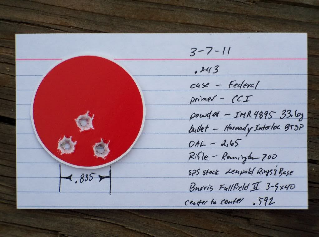

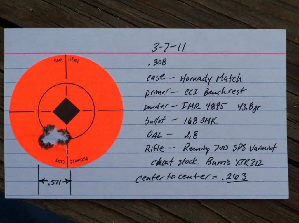

I went to the range today to shoot my rifles. There was a 10-12 mph wind but decided to shoot anyway. The first group is out of my M700 SPS Varmint. Stock is a Choat Ultimate Varmiter, scope is a Burris XTR 3-12x50. This was at 100 yards. The second is out of my .243 which started out in life as an ADL, but I ended up adding a BDL floorplate and later set it in an SPS stock I got off ebay. The scope is a 3-9x40 Burris Fullfield II, mounted with Leupold base and rings.
Nice schooting, and I really like the idea of index cards.
Do you setup the index card with the target on it or transfer onto the index once done?

One was a sticker, the other I had to cut out. I took the target, and attached it to the index card, I have box tape over it now to keep it in place and to preserve. I got this idea from a guy at the local gunshop, he was using playing cards, I decided to do this so I can have some specs on it too.

Shoot 5 round groups! It will give you a better idea of the rifle and shooters abilities.
+1 The only time I shoot 3 shot groups is when I know that a certain ammo type or reload type already shoots small groups.

Oh ya, good point about 5 shot groups. The .243 I was thinking that the most I would shoot at a deer at once would be 3 rounds, so I had thought about that already while I was developing a load. The .308 I was just shooting to have fun, and thought, wow thats kinda tight. Now you got me thinking about doing a card for a 5 shot group.
