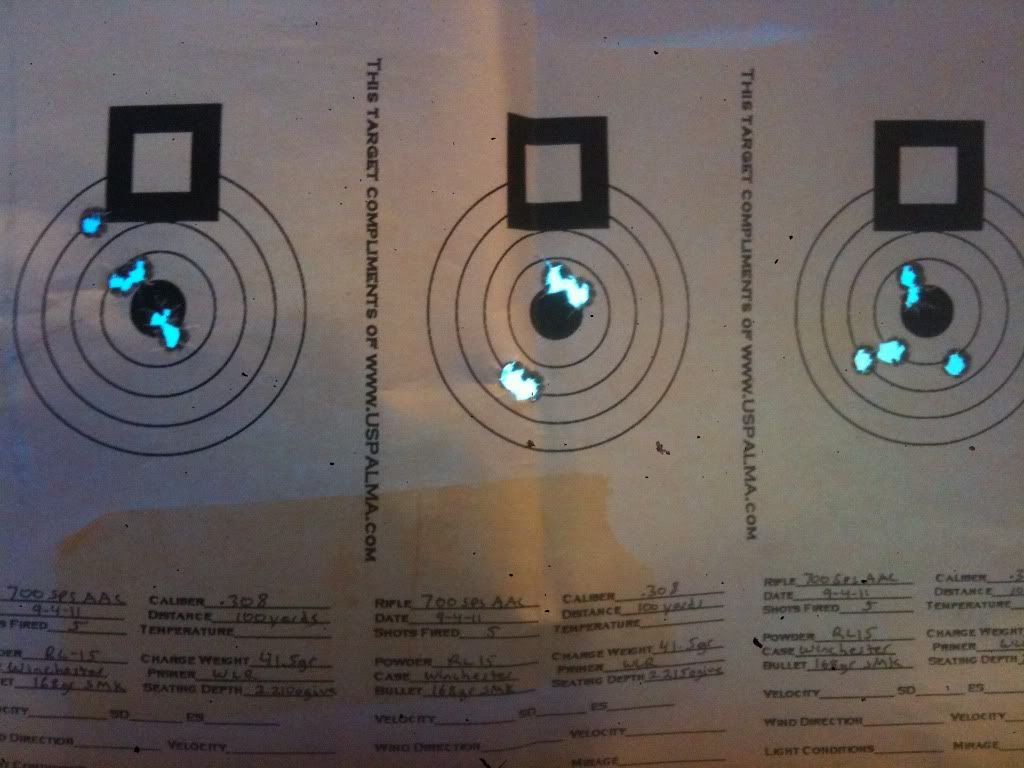

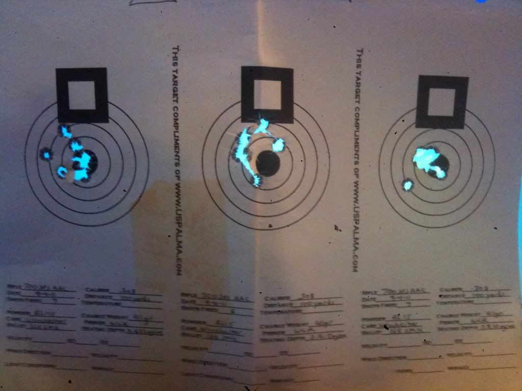

Test load data. Different powder charges and different seating depths.

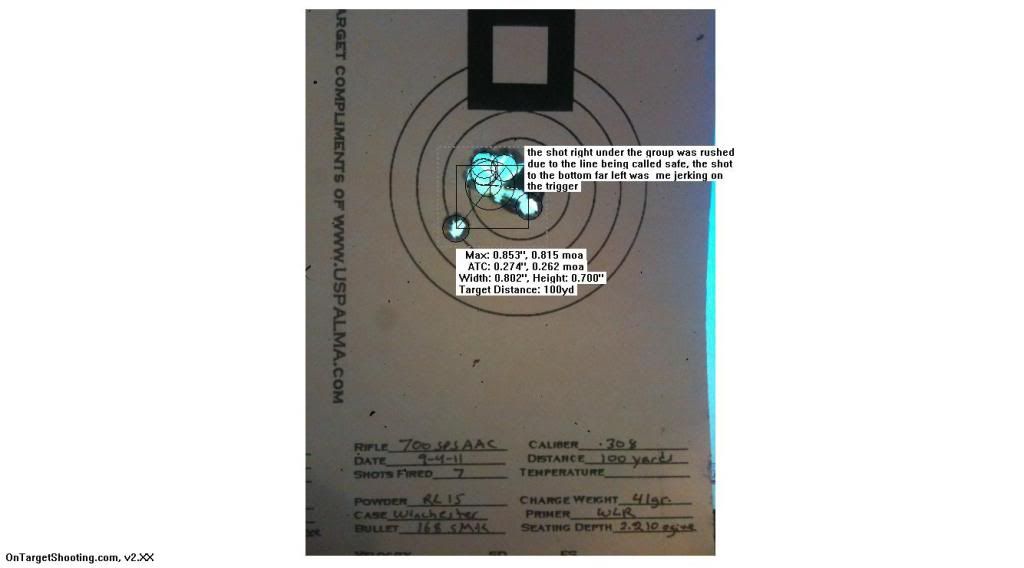

a 5 shot group at 0.262 moa.
Only thing on the load that is not posted is the brass length, a little shorter than average. I run my brass now at a 1.996 instead of the 2.005

Thanks Sully, it's amazing the difference in accuracy .5 of a grain or a .005th of a inch on seating depth can make.
That last target with the one hole is definitely going to be my Go to round for 168gr Smk.
