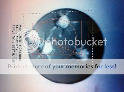

Well got a chance to get out to a range and try some of my 168g HPBT SMK's I reloaded.
Heres the breakdown
168g SMK
42.0g IMR 8208 XBR
Win Brass trimed to 2.005"
BR2 Primers
COAL 2.800"
Avg Vel 2660 fps
The end result, group at 100yrds, Avg CTC .434"
Im sure I could have done better but my rifle has not been camo'd LOL!
