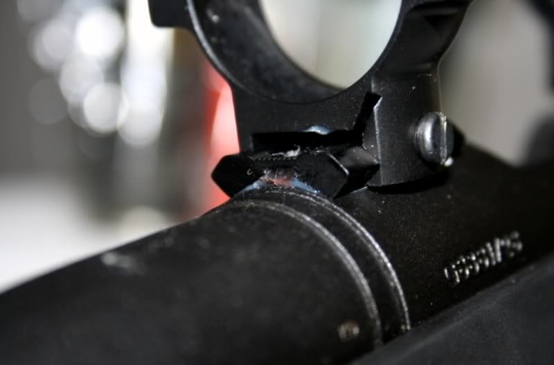

Thought everybody should see this. I asked a friend of mine to mount my new scope to the SPS since he said he's done this before. Well, he will never touch one of my rifles again. Take a look at the bases, and yes that is silicone. Hopefully this is how you post pictures on this forum. If not let me know how.
http://www.flickr.com/photos/[email protected]/4166274719/
http://www.flickr.com/photos/[email protected]/4167034126/
http://www.flickr.com/photos/[email protected]/4167034164/
http://www.flickr.com/photos/[email protected]/4166274699/
And here's how many clicks it took to zero at 25 yards.
http://www.flickr.com/photos/[email protected]/4167034144/
Thoughts, concerns, sarcasms? I have since removed all this (after many choice words), reinstalled with vise and levels, and eyeball boresighted.

My only question would be, "WHY!!!!" I really don't believe that there could be a web site some place that tells people to silicone scope mounts.
At least you're on the right track now.
I believe his exact words were, "There's no way water could get in there now to rust, and it'll keep it locked in place no matter how many rounds you put through it". Being an engineering student, I was at a loss for words as to how to explain his folly. I'm actually ticked off at myself for trusting him enough to not check his work, but you know what they say about assumption. It just didn't dawn on me that he of all people would do that... a prior service Marine.
The continuation of this story is when I took it to be boresighted at the local range, that the "armorer" there didn't believe this little civilian. Rather infuriating when that guy put everything back together without loc-tite or cleaning the receiver which still had silicone on it while they kept telling me I'm the idiot.
So, after much CLP, acetone, and elbow grease I have the SPS as pristine as possible. Other than never let either of them touch my weapons again, I hope I can lean on you guys a little if I've got technical questions. I'm afraid they'd tell me to bed the rifle with bondo.

I have heard/read of that being done. Not by anyone that I would actually trust though. However, it actually would seem to be counterproductive to the idea of bedding. The silicon would flex way too much to actually insure a consistent fit between the base and the receiver. You would either tighten it down enough that it would squeeze the silicon out (thus negating the whole purpose of bedding) or you would have the base "floating" as opposed to bedding it onto the receiver.
For levelling, I like using an automotive feeler gauge. You mount the base and bottom rings, and then lay the scope in the rings halves and start the top halves of the rings onto the bottom. Get the rings snug but not tight. Then use the feeler gauge to insure that the bottom of the scope stays flat against it (and thus parallel to the base) while you snug the screws down evenly. Torque as appropriate and pull the gauge out. Of course you need glass that has a flat area on the bottom of the adjustment turret area to do this.
